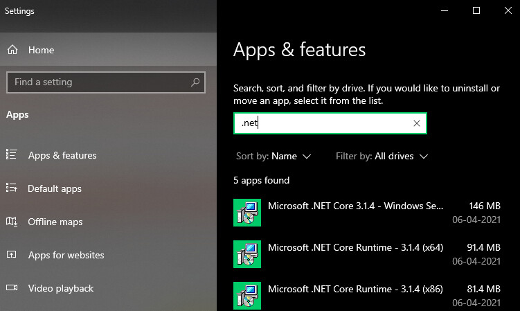

Hi @BramVanDeMunt ,
In the Prerequisites for using the Tool, you have to download the .Net as shown below:
Could you check if you have .Net Core installed on your PC?
Kind Regards,
Ashwin A.K

@Greg_Guidone I found a solution to this problem, as I was having it as well.
I was downloading and using the x86 architecture version of .NET Core, but the Migration Tool requires the use of the x64 architecture and will fail to open without it.
@BramVanDeMunt ensure you are downloading the x64 architecture and try again please!
