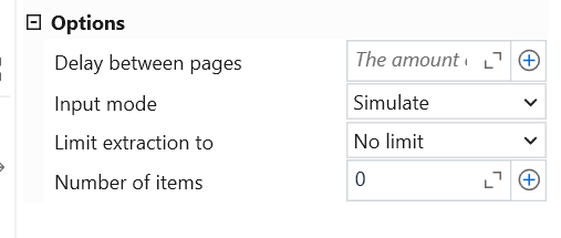

I am new on UiPath, and I am trying to execute a simple use case : click on each line of a web page:
This web page can contain x amount of lines and there is no Next page.
I am using a “For each” and it works well in the beginning but after around 18 lines it stops without any error message and I do not understand why.
The for each doesnt have limit and has input mode of Simulate:
Thank you for your help !

I think you are using “extract table” activity based on screenshot you have shared of activity property in main post unless there is new update to “for each” activity.
