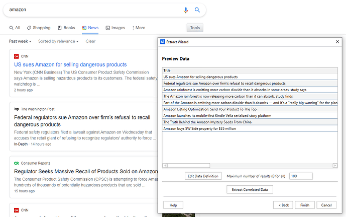

I want to get all the links and titles about amazon for the last week.Can u help me?
Ok my friend, @sedayngl_sedayngl33
In this case, we will type “amazon when:7d” in the Google News search bar.
This way, we will have the news of the last 7 days.

You should use Data Scraping for this. It’s what it is intended for.
I was able to easily extract the title, summary, when posted, and source.
