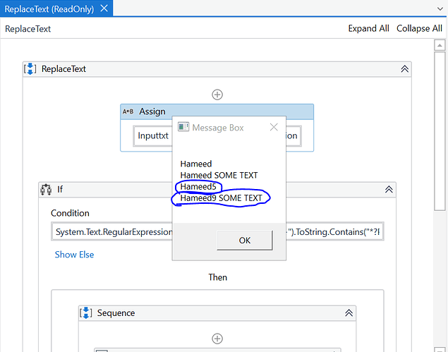

When I try to replace I got the below error to refer to screenshot. Also, I tried to find the exact match with regex still it’s matching with all the cases, can someone help out with this.

Hi Gokul,
thanks for the response but still it’s replacing the below texts, it should not replace the below two as am replacing “Hameed” only for (?PipinInstruction1) not (?PipinInstruction15,*?PipinInstruction19 SOME TEXT)
*?PipinInstruction15

dear all,
It’s not worked it’s replacing as “hameed” everywhere “*?PipinInstruction1” in the txt file.

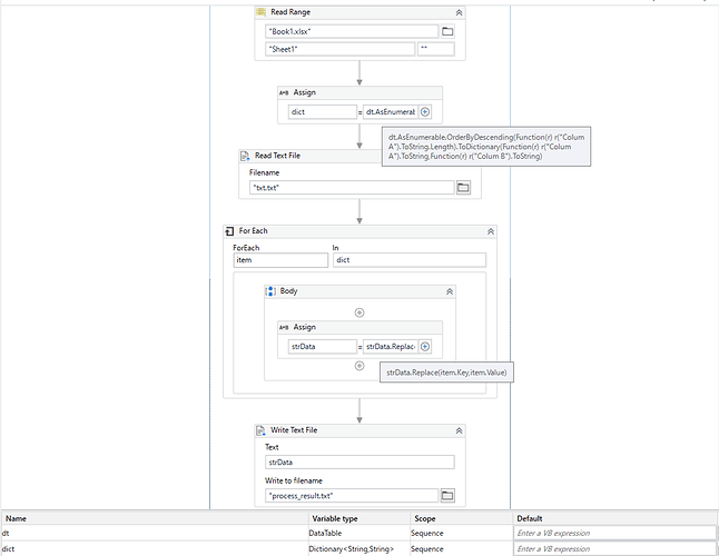

Actually, the concept is, am running in a loop from the data table, for example, I’ve 4 rows each row I’ve found an exact match from column A and replaced with column B value.
However, the problem is when run 1st iteration it’s replaced correctly, with the above solution you shared. still, it’s replaced as “hameed” for ro3# & row#4.

Thank you for sharing. Can you try the following?
Note: I modified master xlsx sheet as the following.
img20220324-5-1
Sample20220324-2v2.zip (10.1 KB)

Thanks a ton :blush: this will help me a lot, thanks you so much for the support​:blush:
