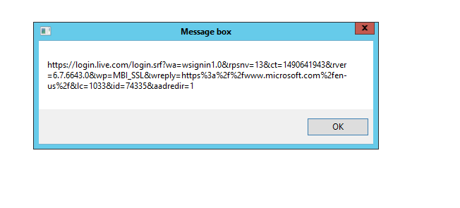

@aksh1yadav Attached code should return 2 different Url’s, I think I’m missing some thing with variable1, can you check.
microsoft.com
live.com
browserurl-attribute.xaml (10.0 KB)
browserurl-attribute.xaml (9.5 KB)

I see you used Navigate URL for the transition can’t we achieve with Button click?
User asked he wanted to see what ever is on the screen.
In this context, user opnes microsoft.com > clicks on sign in > goes to live.com> after successful auth comes back to microsoft.com
With all it will work. You have to maintain the delay here because you are getting things from browser and its properties so if you will fire the get-attribute with url before the loading of next state it will return either the previous one (when you are switching from one state to other) otherwise default like “about:blank”.
check with sign in click sample: browserurl-attribute_with_click_sample.xaml (10.7 KB)
Regards…!!
Aksh
gave 10 second delay in your code.
I will check later. Thanks.
Regards…!!
Aksh
Lol…12 second delay worked. Thanks for the help man!
