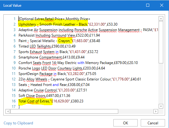

This is the output, the highlighted words are what should be removed
And here are the two variables which should match this (pTrimtoRemove is the same as oInteriorTrim).
What am I doing wrong here?

Now I got your issue…
Ok so please use OR condition…And means all the 3 variables that you provided should be in the same row then it would remove…
If any of them is prsent and it needs to be removed then you have to use or condition
cheers
Ahhhh thank you for explaining! All sorted now!
