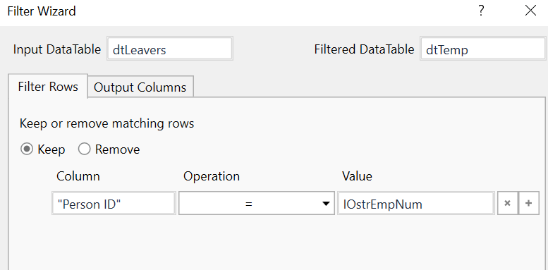

Hi @nela.mencer ,
Could you let us know what was the implementation done for the Filter part ?
Are you using Filter Datatable activity ? If so, Could you send a Screenshot of the Configuration done ?
Also, Maybe Performing a Debug on the datatable and checking its values would be able to help you in pointing out the irregularities in the values if any.

Thank you for fast reply. Please see attached images.
I have created DataTable collection with 3 excel reports (dtListOfCollections). Then if the Employee ID is not find there, I duplicated the work only for problematic dtLeavers, to look at it again for Employee…
Employee ID is in variable called IOstrEmpNum (this is read from request in email)
But even if I amend variable IOstrEmpNum for Emloyee ID number, still is not find.

@nela.mencer
I see that the personal id in the table is of type number…so in the filter please try Cint(IOstrEmpNum) …
cheers
wau, Thank you very much! It works! Honestly, I spent days to sort this out! Thank you!!!
