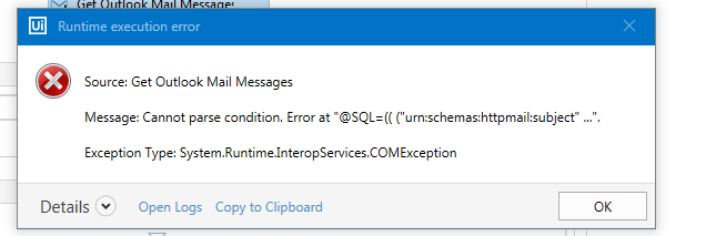

\i need to add a filter in filter option.please suggest.
no it is always going to true… condition
