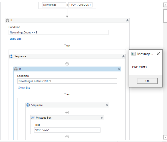

@Srini84 But if i want to know the name of file which is missing amongst the 3 files then in that case will it help?
You can take below as reference and change according to your requirement
Hope this will help you
Thanks
@Srini84 NewStrings variable is an array of strings?
Yes, that’s array of String which has PDF, CHEQUE
As you have 3 strings in array so If all three are captured then put condition as Array.Count = 3
If it is 3 then it will execute the the then part, or else it will execute else part and there you can put If condition and Array.Contains(“Your Value”) using this you can capture which element is missing
Declare a variable and then add to that which values are missing
Thanks
