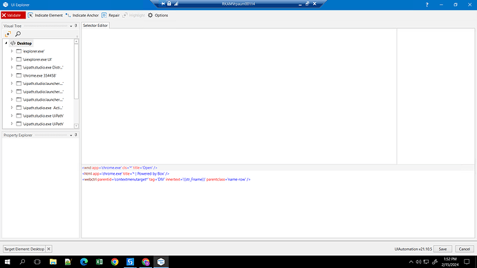

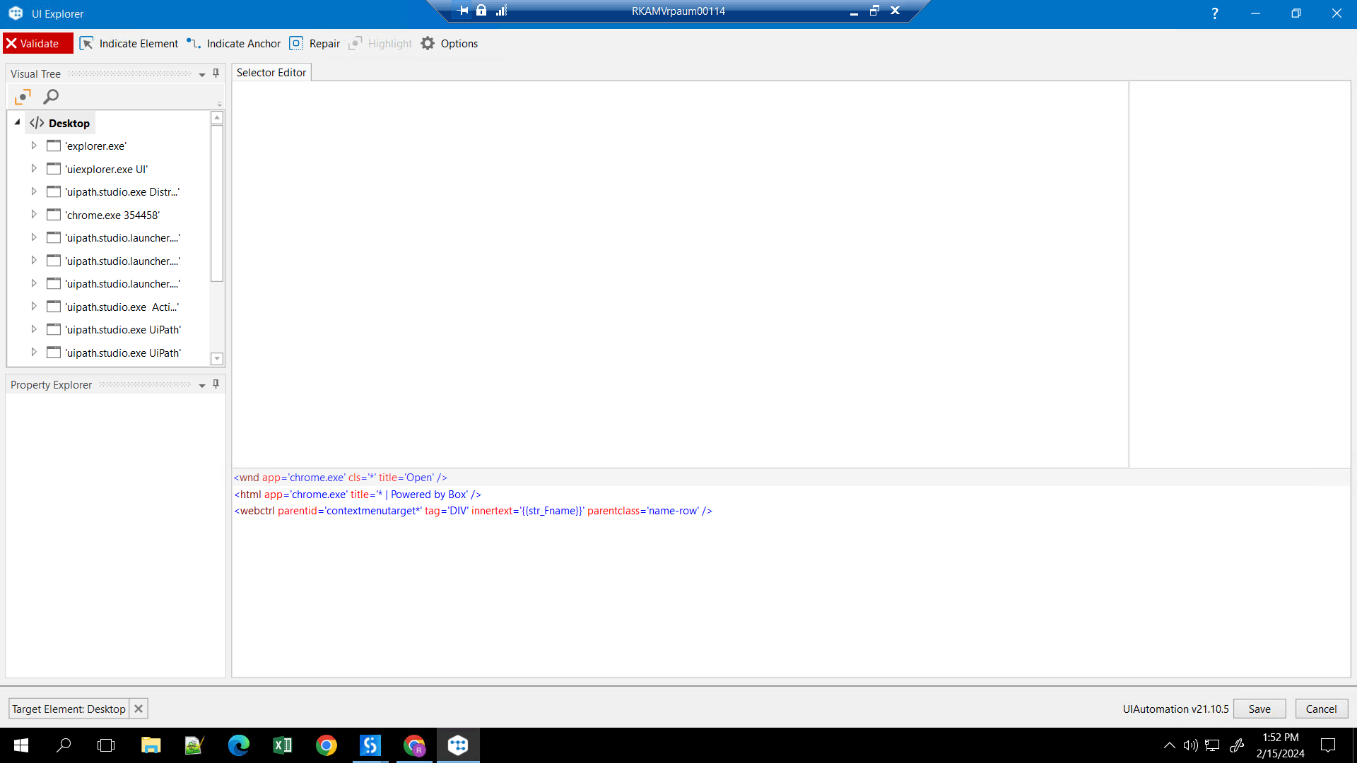

Hi All , I am uploading the file in box.com after upload when I am validation the file got uploaded as show in second screenshot then in that case name having &amp if failing to validate but names without &amp is getting validated any guess why it can be the issue.
—Selector for validating the files got uploaded or not .
You can html encode your string before checking it with Element Exists.
str_Fname = System.Web.HttpUtility.HtmlEncode(str_Fname)
This will convert for example "A & B" to "A & B".
