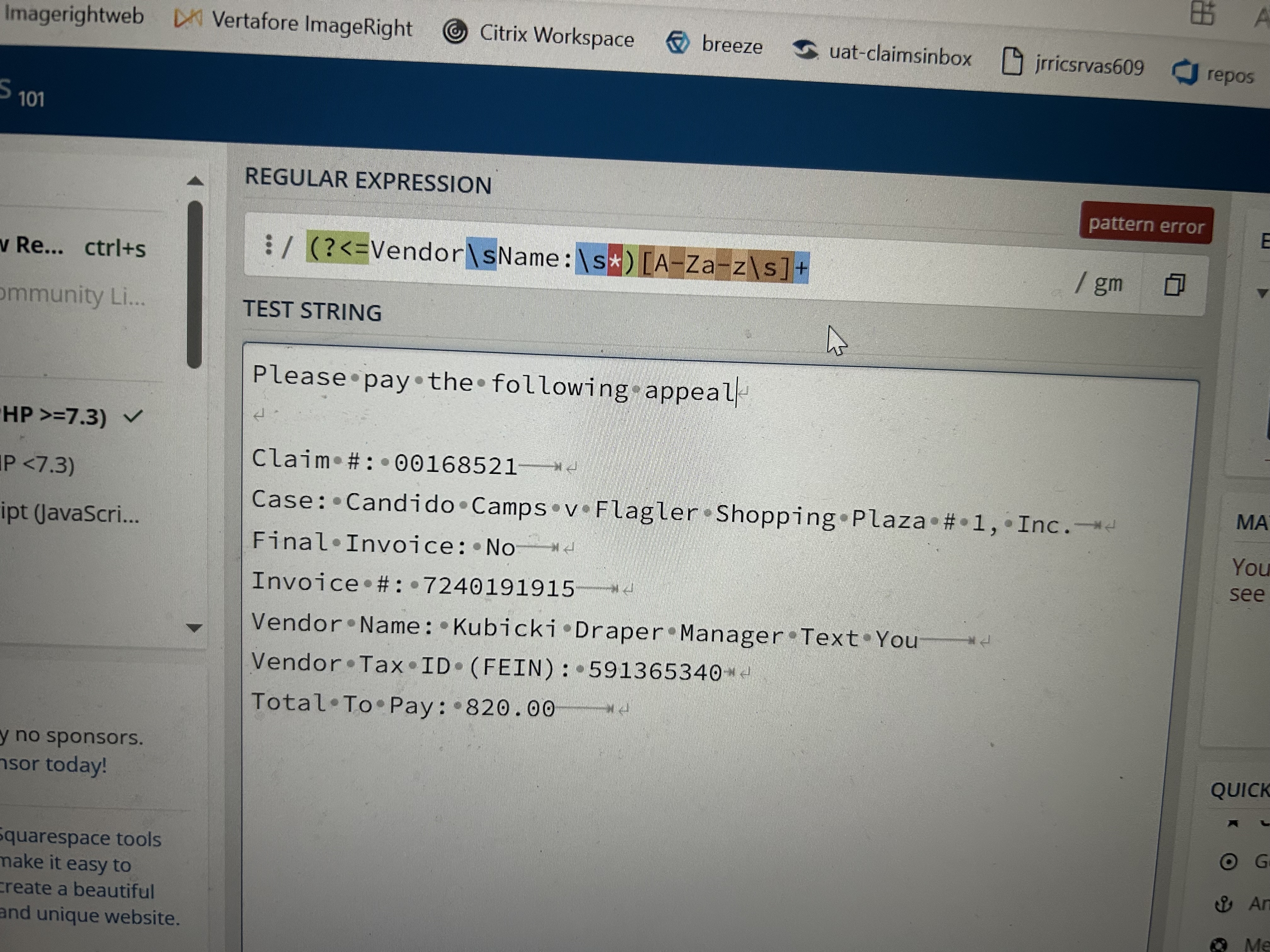

Tried using the above mentioned regex but getting error
try this
(?<=Vendor Name: )[\s\S]+(?=Vendor tax ID)
If you are using regex 101 please select .Net C#
UiPath is based on that language
