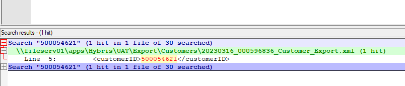

Is there a way to read (extract) specific data from the search results in notepad++ ?
If I use check app state ot get text activities its take the all area in the search result.
I know there is a way in XML to read text file but is there a way with notepad++ ?

Its not a saved file.
I am open the notepad++ and search->find…->find in files->find what (paste a number)-> and pressing find all button
then I am getting the search results

@Anil_G But its a search on notepad++
On notepad++ you are trying to open reference a file and then search for some value in that file …am I correct? Or is there somethign else that you are trying to acheive…
@Anil_G
I guess then you cannot extract separately but can try using regex to expract only the line values
System.Text.RegularExpressions.Regex.Matches(ExtractedText,"(?<=Line).*")
You can loop through this …its an ienum of match …which can be accessed in the loop and then can get each matched line
Extractedtext is the text extracted from whole search result
@Anil_G
How to implement that ?
Use the expression in a assign activity or you can copy the regex inside it
(?<=Line).* And use it in matches activity…the output can be looped using for loop

Thanks, but I am not using saving file, I making a search

The Data is sorted in the network some folder - I pull it from there Using CustomerID number
Then I need to see in the search result that the XML created
