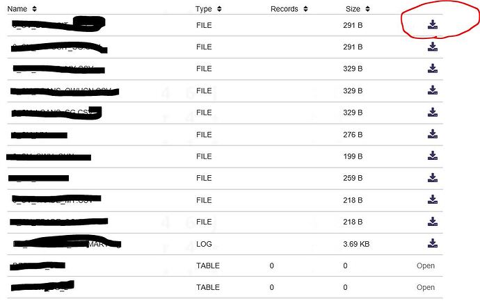

based on the attached image (it’s a web based), i extracted it as a data table and use for each row, to click on download (circled) the file (only download when the type is “FILE”. This works fine when all file type in either FILE pr LOG.
But when there is a file type with “TABLE”, the click activity doesn’t work on the download button, even though i only download file type with “FILE”
Have a separate condition for Table type alone
Anyhow u have the datatable and must be looking in with a for each row activity
Then inside that loop use a IF condition like this of type is equal to TABLE then use this click activity that has the selector to click on that text Open (as seen in above image)
Or click on normally that download button

It does seem that the Selector is different between the Table and File/Log type.
If by analysing using the UiExplorer we find there is a ColNo attribute that we could use, then maybe a generalised selector could be possible for all three types. A checking/Testing would also need to be done.
You can directly use for each ui element activity…
From the screen we could see a difference between the downlaod button and open button…try to get a common select for both so that we cna use that selector to click on any type …as suggested by @supermanPunch going with column Number might help
