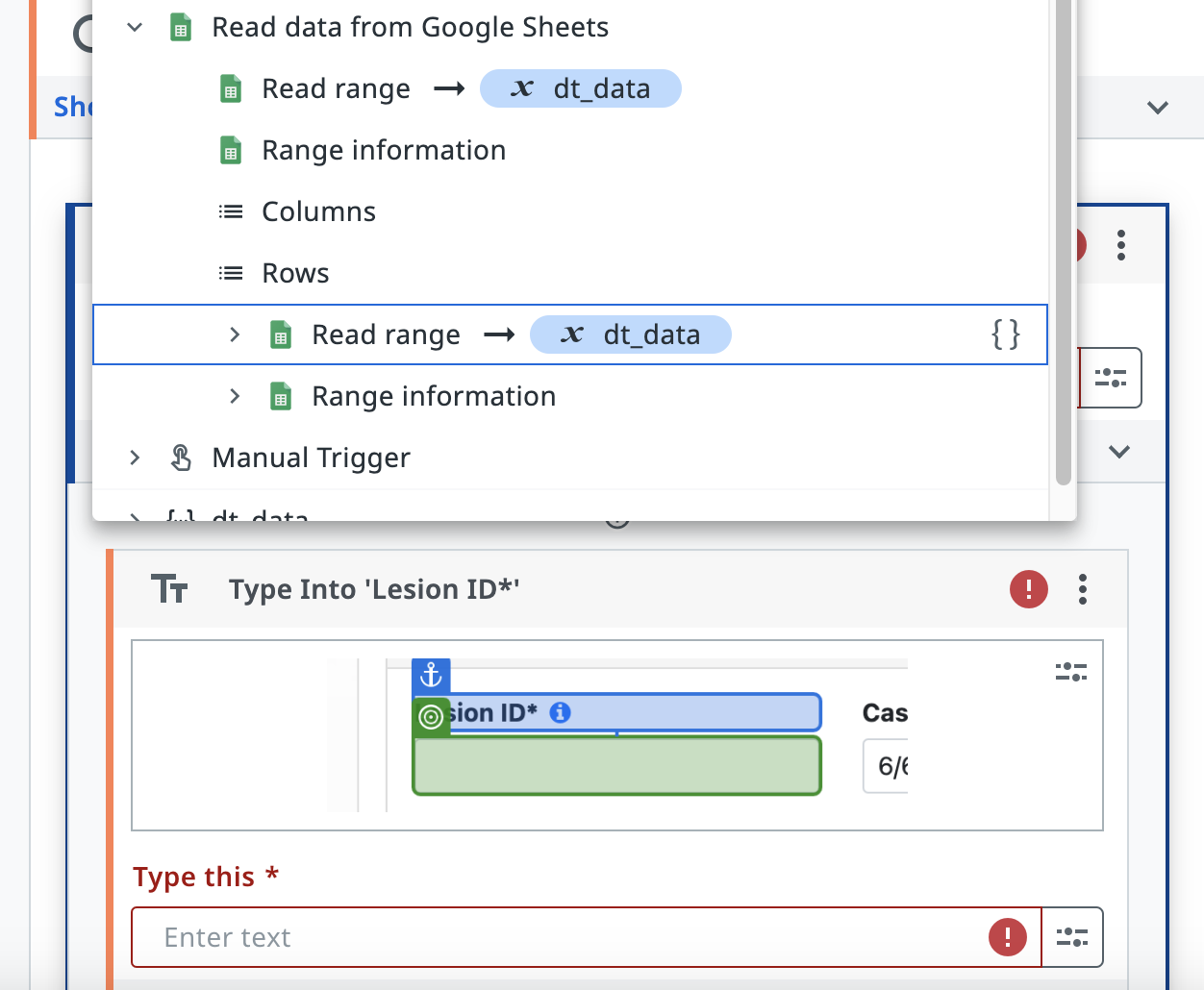

  1. how to actually make it pull the data from the Google Sheet ("Input data into ‘Case ID*’ field). When I select “Read Data From Google Sheets” and select for example “Rows”, it just inputs {x}dt_data.Rows. Have no idea what to do with this, and it obviously doesnt work as is

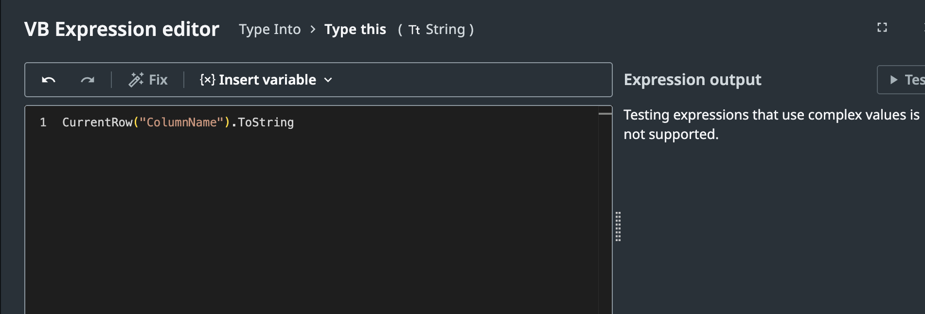

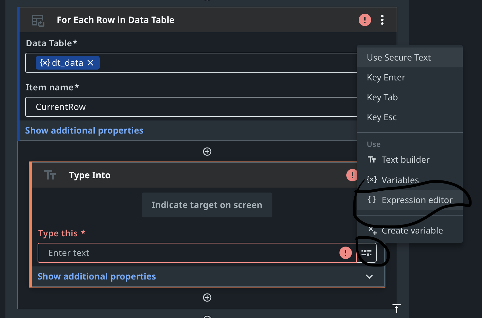

You can directly use For Each row in Spreadsheet and inside that use Type Into activity and open expression editor you can type CurrentRow("yourcolumnname").ToString.
Hope it helps!!
@z4merchants
The output of it is already indt_data ..so scroll down expand dt_data you would see rows..which on expanding you can select the column you want..as its a datatable for eqch row would be added automatically once you select a row component

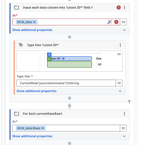

Thank you, unfortunately still having trouble figuring it out. I see the Column ID in the Read From Google Sheets dropdown, but it doesnt actually resolve the error. See screenshot:
screenshot was wrong - of course I put Lesion_ID in the “your column name”
@z4merchants
can you show the error please
may be it is using a for each activity
can you switch it with for each row in datatable activity mostly that is the error
cheers

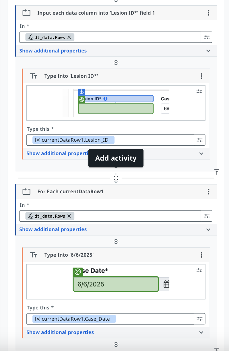

I got it to read the Data Table and pull the 1st Column data, but current problem is it is just iteratively rewriting Field1 text with each row’s data into the 1st online form field, without ever moving on the the 2nd field in the form. Screenshot below
What it should be doing is:
  1. entering Row1-Column1 data into Field1 in the online form, then moving on to Row1Column2 data into Field2 in the online, then once all fields are entered
  2. submitting the form and restarting the process for the next form from Row2Column1

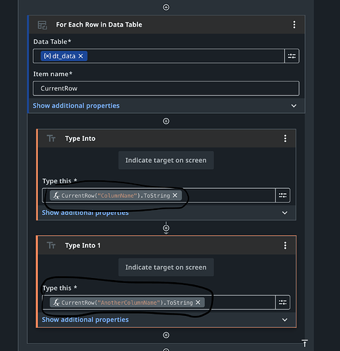

first thing you dont need separate for each for each field inside one you can use all
coming to the values this is how the expression should be ..
if the scenario is that you have a form and you need to fill first row and then submit and then the form reloads and you need to submit the second row then the way I have shown you would work
changinf for eahc to for each row in datatable is easier to use
cheers
