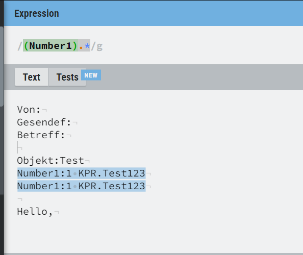

System.Text.RegularExpressions.Regex.Matches(Input,"(Number1).*")
Unfortunately I get an error and I don’t know why!?

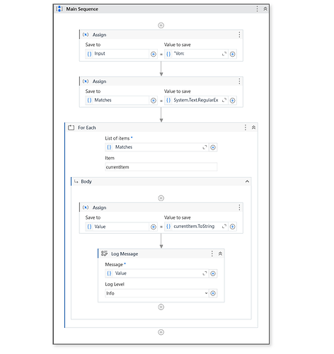

Is there no way to keep it as a string because I still have to use replays with the string?!
@Energy
You can store it in a String variable in the below code, Value variable datatype is System.String
Please find the below xaml for your reference
BlankProcess15.zip (41.5 KB)
Hope this helps!!
Hello,
Thank you very much, I had to try it briefly in my process.
It worked, thank you.
