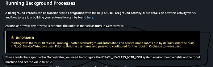

  1. you can force to use user creds . Configuration specified below
  2. Give access to netowrk folders to session 0 which generally would be a concern( So prefer first option)
To use credentials specified in Orchestrator, you need to configure the UIPATH_HEADLESS_WITH_USER system environment variable on the robot machine and set the value to True .
