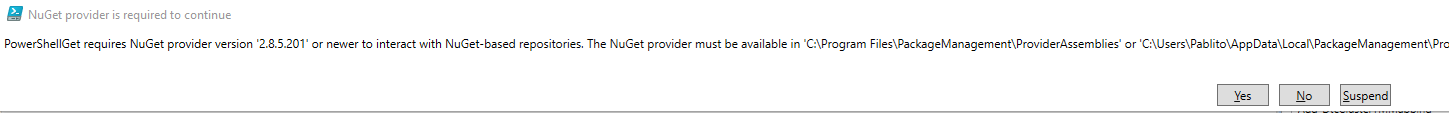

In your script you are importing the external PS module. I suggest to install it firstly in powershell by Install-Module MSOnline and then check if importing it in the script is working. The main problem here is that powershell is waiting for input during the import like in the screen below:
UiPath Studio can’t properly use it and just throws an error.
EDIT: Install it running PS with ‘as an Administrator’ option.

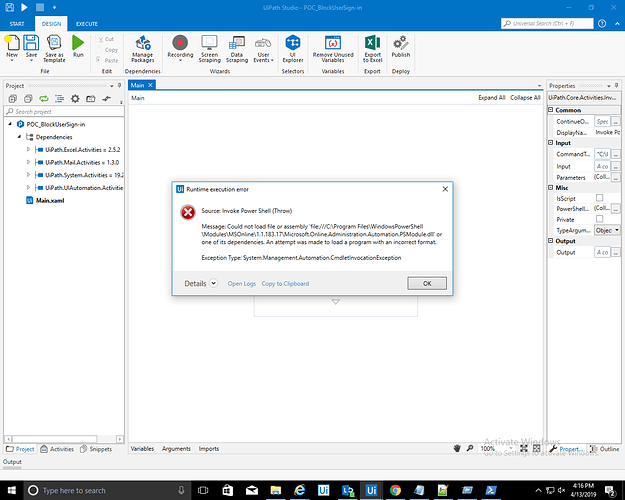

I tried it already @Pablito. But again i got an exception only.
I got the below exception.
@Iswarya.G try the same but please mark IsScript in the options for the activity.
@Pablito, I tried all the scenarios But, I didn’t get the exact result.
