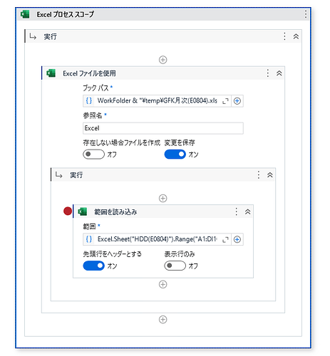

I am using the “Read Range” in Excel files as shown in the image, but it took 15 minutes to read the range A1:DI1000.

As a quick fix, I think you should try setting the Read Range activity to explicitly format the values as “RawValue” and turn off the display rows. Please check if this improves the situation.
The display rows were originally OFF, so when I set the format of the values to “RawValue,” they loaded instantly! Thank you.
