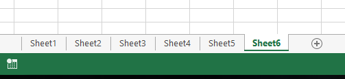

i have one excel file with mutiple sheets
Want to rename the sheets name
excel_sheet
want to change as these names(As names may add…so have to dynamic)
excel_rename
