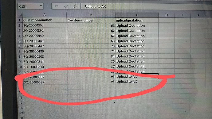

In excel data I need to remove the last two row

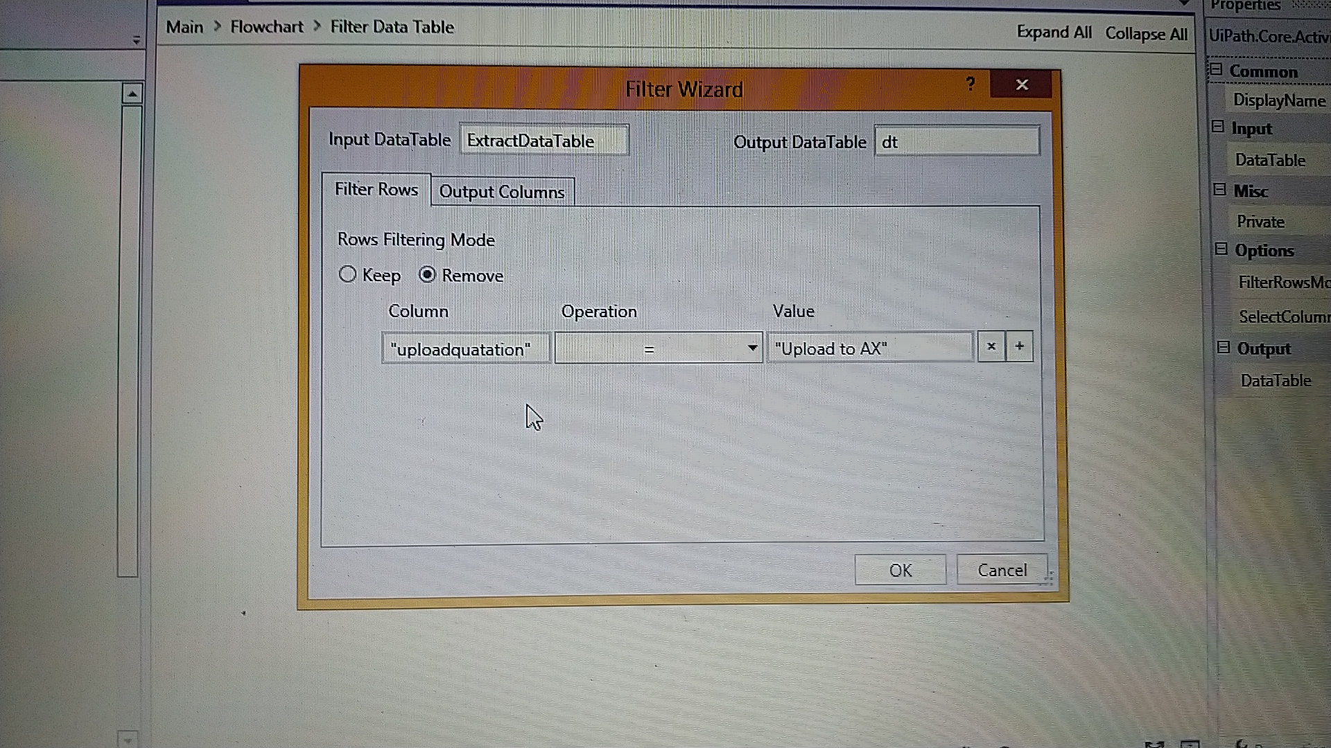

Use filter datatable
and use condition as
uploadquatation = “Upload to AX”
and use remove row option
Right
Where I drop remove row option

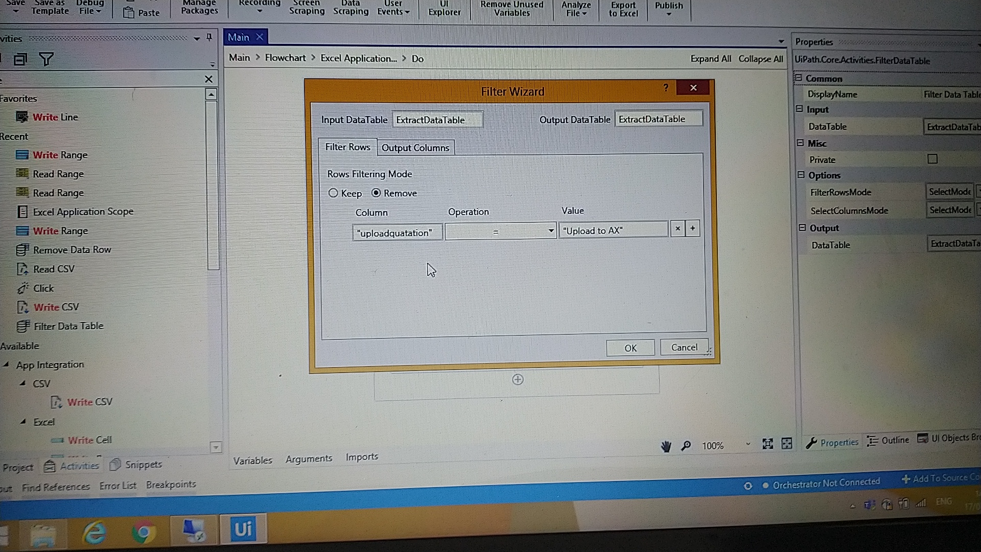

U already did it in screen shot
But still not remove that
Now u can write that datatable in new sheet u will get data without that rows which contains “Upload to AX”
I done it but it’s not worked still

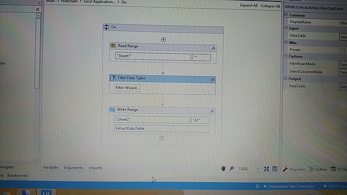

If you are write it on that sheet only then it will show as previous as last two rows of previous data is still there
write it in another sheet using write range
Or u can use as @balupad14 suggested.
I did that also but still not changed in other sheet also

Hi @siva_sankar
Actually der is one blank space infront of the word in excel
Like this " Upload to AX"
I have updated the workflow now and it is giving output also that you want.
