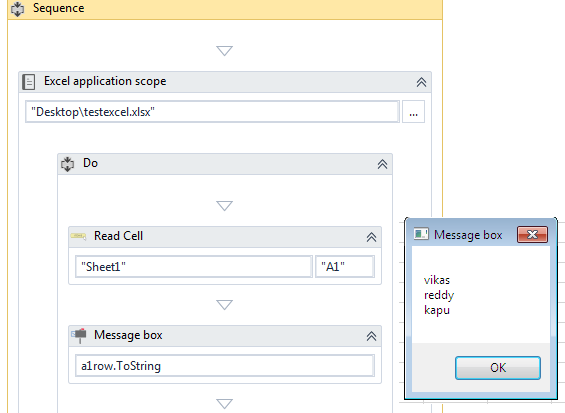

Please excuse for the Input data I have used. You can do this in the following way;
  1. Use Excel Application scope and get the data from the cell as shown below.
  2. Use Goole OCR engine to get the Data for the Visible region asshown below:
  3. Now compare these two output data to get the Selected and Ignored Values
Vikas

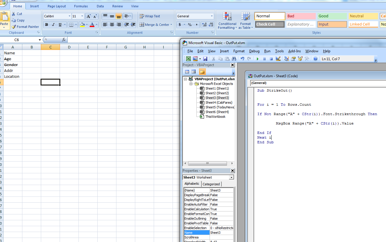

Hi @kuldip.gohil,
I found an alternative solution, it may be useful to you…
Write an excel macro and call that macro from Run Excel Macro Activity…
It will display the values which are not having strike on value…
Plz be revert with response…:slight_smile:

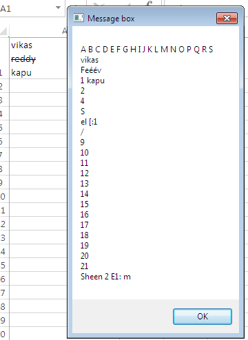

Dear @sankar.kuna,
Macros will give Boolean output if the content in the cells are in single line(Is the case which you have done). where as @kuldip.gohil had multiple lines in 1 cell to which macro is not able to read them.
Vikas
