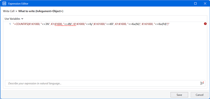

Thank you so much , but when it apply in my case, sth get error
Can u help me check on it?
Hi @Happydayyy
Use the below one:
"=COUNTIFS(K1:K1000, ""<>3N"", K1:K1000, ""<>4N"", K1:K1000, ""<>Ky"", K1:K1000, ""<>KR"", K1:K1000, ""<>Kw(Ni)"", K1:K1000, ""<>Kw(Pd)"")"
Hope it helps!!

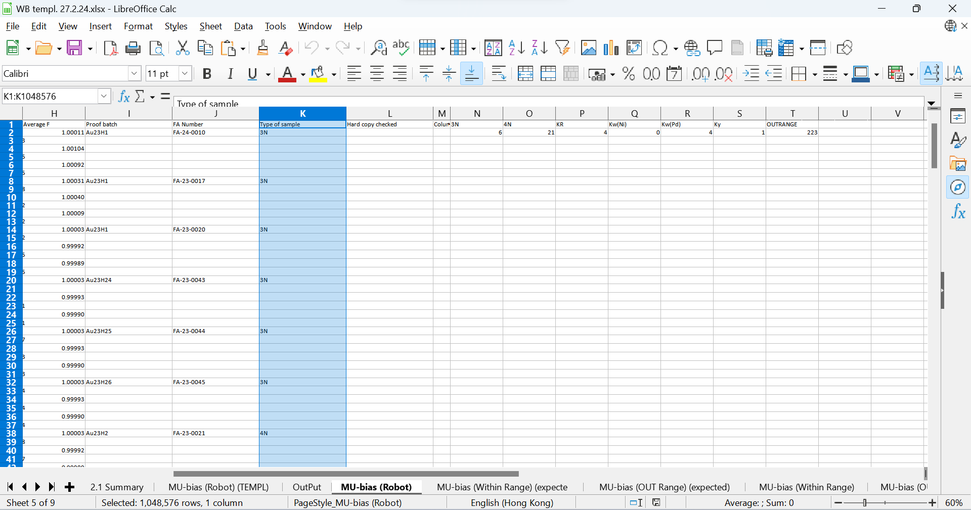

Because the area is based on the number of data in main sheet, so the number of data will be different, i can’t just use the specific number ie K2:K259, I must use up to K1000.
So i am still thinking solutions to cope with this…
I use your formular but its still have 223
But it is suppose to have 7 only
WB templ. 27.2.24.xlsx (83.0 KB)
check on sheet "MU-bias (Robot)

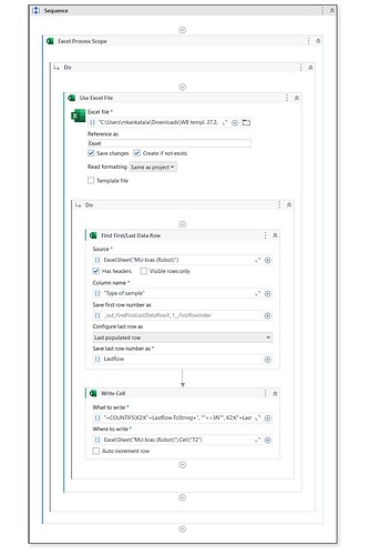

Okay @Happydayyy
I have made a Workflow for this,
→ Use the Find First\Last row activity to get the last row of the Type of sample Column, in the Save Last row number as Field create a variable called LastRow.
→ After Find First\Last row activity insert the Write cell activity and give the below expression in What to write field,
"=COUNTIFS(K2:K"+LastRow.ToString+", ""<>3N"", K2:K"+LastRow.ToString+", ""<>4N"", K2:K"+LastRow.ToString+", ""<>Ky"", K2:K"+LastRow.ToString+", ""<>KR"", K2:K"+LastRow.ToString+", ""<>Kw(Ni)"", K2:K"+LastRow.ToString+", ""<>Kw(Pd)"", K2:K"+LastRow.ToString+", ""<> "",K2:K"+LastRow.ToString+",""<>"")"
Check the below workflow for better understanding,
Regex_Practice.xaml (18.3 KB)
output -
Hope it helps!!
