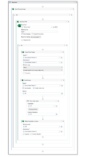

I have two excels I have done vlookup and saving the vlookup data in excel1 under column D now I need to filter the columnD with #N/A values and store in DT.
I am using filter data table and gave condition column name =“#N/A” but it’s not working I am not getting the expected output as #N/A is a formula

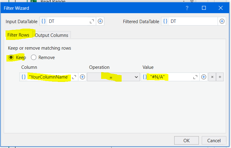

Hi @0bb4628e217fd43ac86ac9294 ,
Please give this a try:
As you say, the column consists of “#N/A”, so add a condition to the existing filter. ex: And columnD-does not contain “Random”.
After reading Excel, the NA values on the control column come as less than zero, so you can filter as less than zero in the filter data table.It works this way
