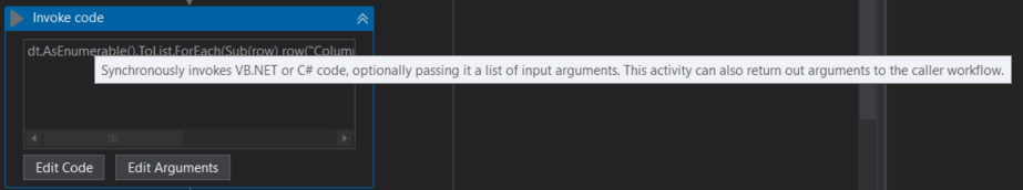

dt.AsEnumerable().ToList.ForEach(Sub(row) row(“Column1”) = row(“Column1”).ToString.Replace(“$”, String.Empty))
you set dt as In/Out argument and assign value of dt2 to it.
You could also remove the $ inside the loop and use filter then.
dt is your datatable, dt1 is the data table after filtering.
