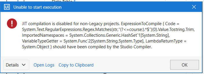

Am getting this Error.
Thanks… but I didnt get.
Put course in upper case and try.
System.Text.RegularExpression.Regex.Matches(str,“(?<=COURSE:).*$”)(0).Value.Tostring.Trim

still the error.

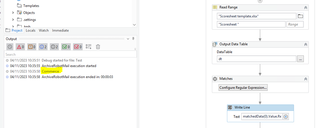

Hi @MEGHA_cs ,
Try this:
Properties of matches activity:
Output expression: matchedData(0).Value.Replace(“,”,“”)
where matchedData is output of Matches activity.
Hope it helps.
