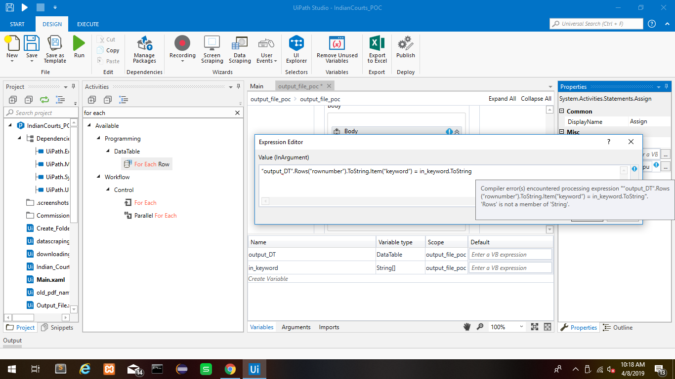

Error in Rows
Hii,
what is the mistake?
Thanks and Regards,
Supriys
@supu123,
Remove double quotes for output_DT dataTable variable and then try.

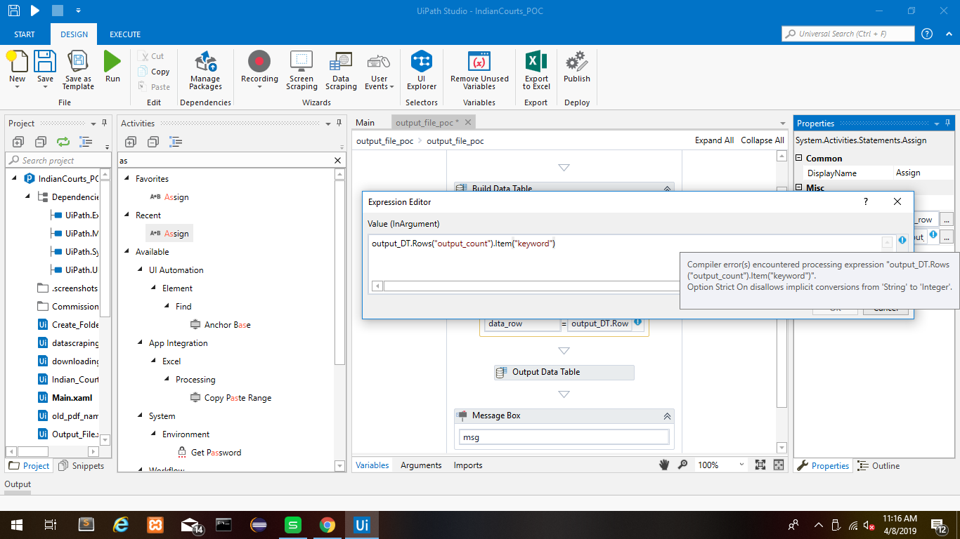

Hi Supriya,
I noticed that you are entering to(outargument) and value (inargument) in value field.
change the fields in assign activity
To= output_DT.Rows(“output_count”).Item(“Keyword”)
value= in_keyword

@supu123
Please share the screenshot

Hi @supu123,
I think it is datatype mismatch.
Please check whether output.DT.Rows(“output_count”).Item(“keyword”) will return string or integer.
Also, check the datatype of LHS.
To convert to string:
A.Tostring() , assuming A is an integer
To convert a string to integer:
Convert.ToInt32(B), assuming B is a string
Hi Supriya,
May I know what is “To” field contains in assign activity?
Hii MSLReddy,
String datatype variable

Hii,
What is Rows(2) doing here
Thanks and Regards,
Supriya
instead of output_count ,I hardcoded the value.
this assign statement is used to add a single value of particular row and col in datatable.
If you want to add complete row in datatable, use add datarow as suggested by lakshman.
