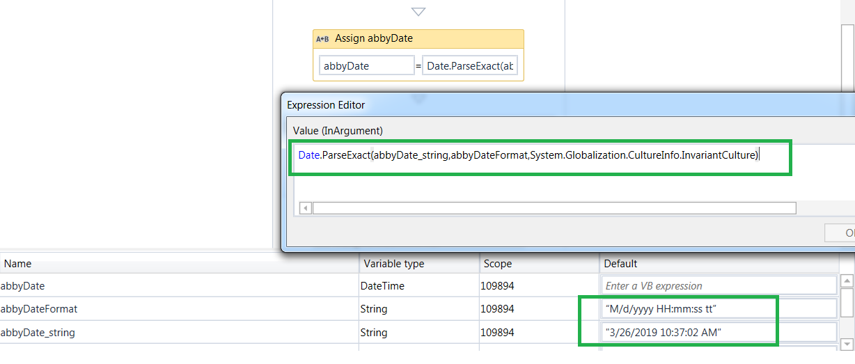

Taking into account that the abby date has the following format “3/26/2019 10:37:02 AM” then you can use the following pattern to convert it to a dateTime variable:
Please, note that for getting the previous year for a date you can use Now.AddYears(-1) instead of Now.AddDays(-365).ToString(“dd/MM/yyyy”) and you will not have issues with leap years
Please, find an example file 109894.xaml (5.7 KB)
