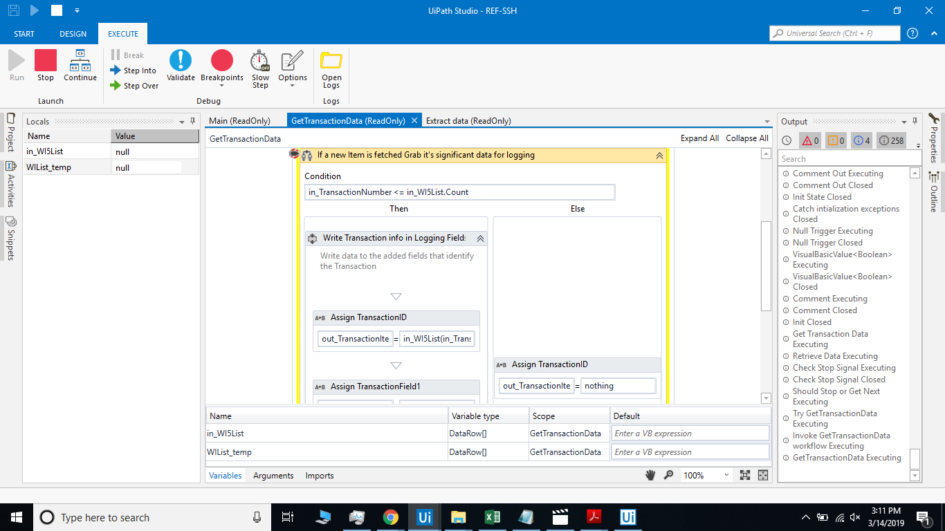

Hii All,
Iam able to extract the data and it is available in Main, in variable “WIList_temp”, just before entering the Invoke GetTransaction data workflow. (Pic 1 below)
When the flow enters the GetTransaction data workflow also the extracted value is available in “in_WI5List” variable.(Pic2)
But when it enters the workflow, both variables “in_WI5List” and “WIList_temp” become null, and Iam unable to move forward. Please help me guys , where Iam going wrong.!
OK, resolved the issue, Problem was I was using the said variables in both variables and arguments. So I deleted it from the variables pane and it worked.
