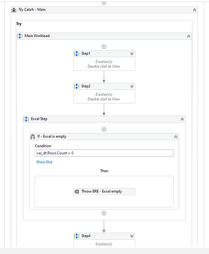

I created a simulated workflow to explain the approach I’d take in this case (assuming you’re not using reframework)

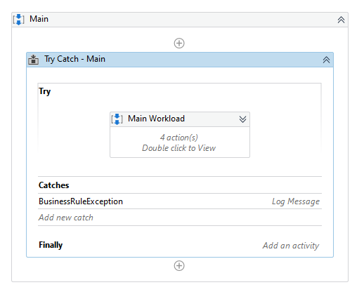

1- Main TryCatch
- Will be in charge to stop your process if you throw a BRE, in this case, Excel Empty.

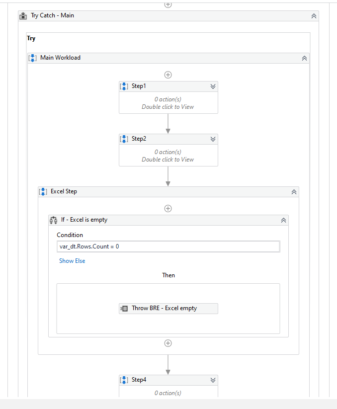

Inside, you have your “X” steps, and Excel is one of them, if there are 0 rows (empty), you’ll throw an exception like you did correctly before:
The bot will identify the Throw Error, and will jump to the catch of the main Workflow, where you’ll log a message stating the failure reason, and the bot will end there:
It will reach the end, and will stop the process.

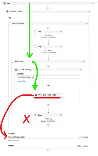

How do TryCatches work?
It will process everything until a SE or a BRE are found, then it will jump to the catch (if it exists)
It will perform any action needed in the Catch, in our case log the message with the exception details, and it will reach the end. In this case, since there are no more actions below, it will stop and finish:
