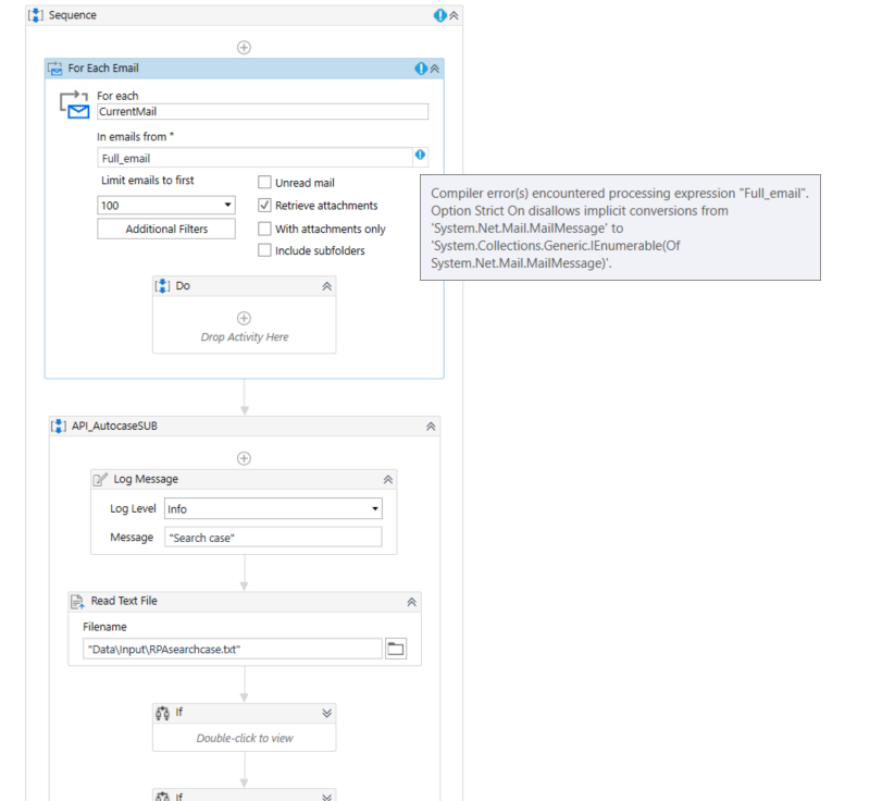

So I wanted to maybe put a foreach at the beginning of the process (API_AutocaseSUB)…foreach email then I can be able to put the email outside of that loop but the way my process is it does that.
My flow from top to bottom:
So I am trying to see If I am not able to pput a foreach at the beginning, but I get an error

Hi @bhavesh.choubey ,
My process structure is like this on the second sequence :
where do I put the loop?
This starts processing from the main sequence
The loop in which you’re processing all the 5 email share me where are you processing all the 5 emails ?
