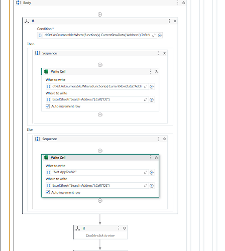

Please check this. I modified the If cndition you have liek this and added one for value…and also removed the second loop

Hi, thanks for commenting. I run it and this is the output

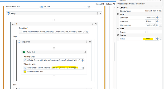

Check the if conditions once if i have given proper columns…and after tostring try including .tolower.Trim on both sides of contains…may be the casing is different
It works perfectly but after it reaches the address with incomplete details the first row is replaced by “not applicable” data
@Shoji
Please make these changes in the xaml
  1. Create variable index - type is integer…assign it to index in the for loop properties.
  2. Remove auto increment check box
  3. Change the cell value to the formula as shown in picture…do this change to all the cell values instead of number give (index+2).ToString
Hope this is clear
cheers
thank you very much, its working properly
