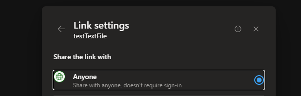

Yes, I tested with a link that looks like this:
https://uipath-my.sharepoint.com/:t:/p/username/blablabla?download=1
That is also set to be accessible by anyone in Sharepoint:
A screenshot of "Link settings" for a file named "testTextFile" showing that the sharing option is set to "Anyone," allowing access without sign-in. (Captioned by AI)
And testing with such URL I am getting the file with both activities:
