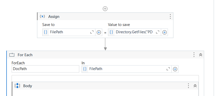

Hi I have checked,
This is how im fetching the files,
I filtered the folder however the two pdf files are there is not getting picked up.
I dont know if that is the .ini file which is a pdf. Please advise?
@Aki1111 ,
Could you show us the Expression used in the Assign activity ?
Directory.GetFiles(“ToBeProcessed”)
@Aki1111 ,
Try using the below Expression :
Directory.GetFiles("ToBeProcessed","*.pdf")
Okay this worked!
