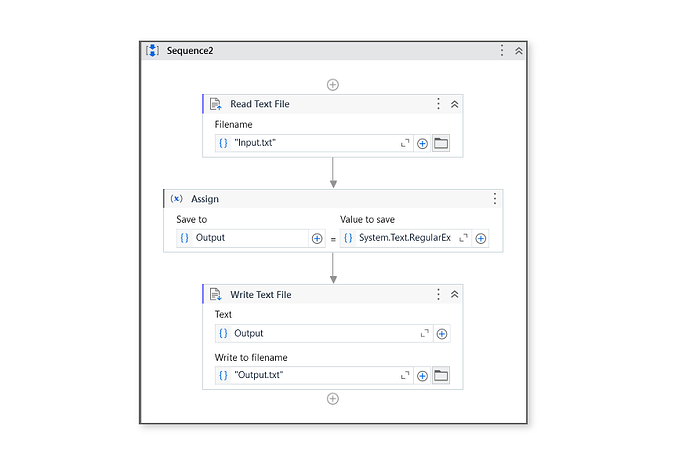

3
Hi @Mesut_Can
Input:
=> Use below syntax in Assign activity:
Output= System.Text.RegularExpressions.Regex.Replace(Input,"\d+.*\-\d+.*","")
=> Use Write Text File to write the output
Output:
Refer below workflow for better understanding
Regards
