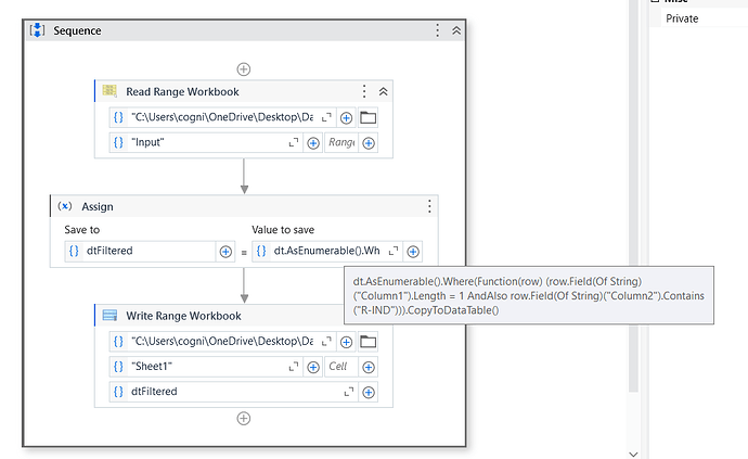

you can use below query
dtFiltered = dt.AsEnumerable().Where(Function(row) (row.Field(Of String)(“Column1”).Length = 1 AndAlso row.Field(Of String)(“Column2”).Contains(“R-IND”))).CopyToDataTable()

thanks @neha.upase Please check revised sample file attached
thanks @Unnathi_Bhat Please check revised sample file attached
