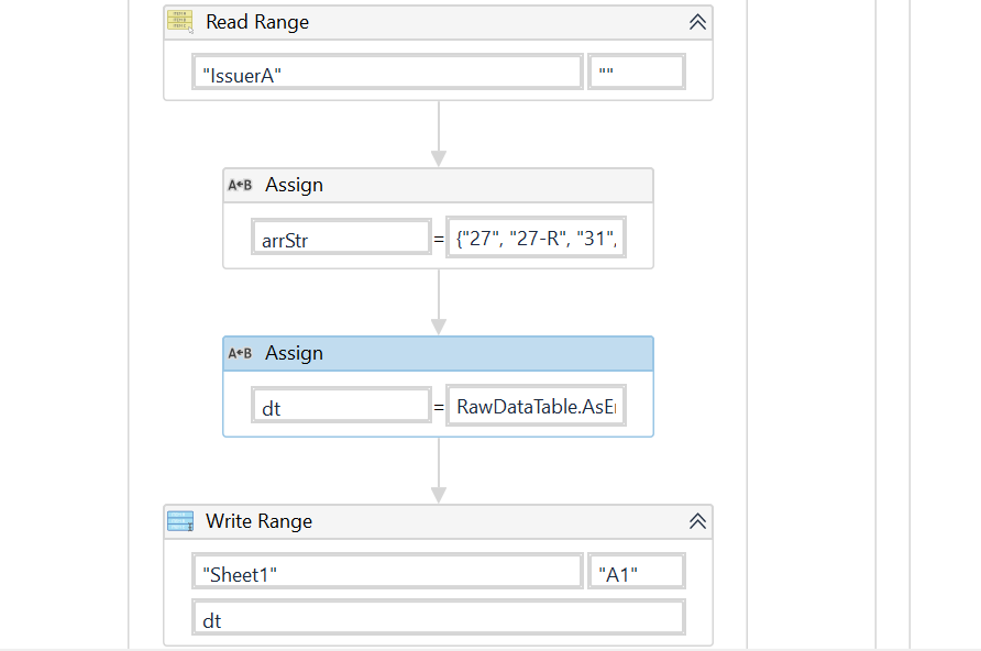

Hi Yoichi, thank you for your response. I have tried using your suggested solution but there is a slight challenge. Is there a maximum number of data rows that can be processed? It seems like some but not all the data rows that meet the condition were deleted. my data table has a total of 20 100 rows
Actually it looks like none of the data rows are being deleted. Not sure if i am doing something wrong
RawDataTable.AsEnumerable.Where(Function(r) Not arrStr.Contains(CStr(r(5).toString))).CopyToDataTable()
Blockquote
Hi, it worked
after i started using headers in my table! Thank you so much
