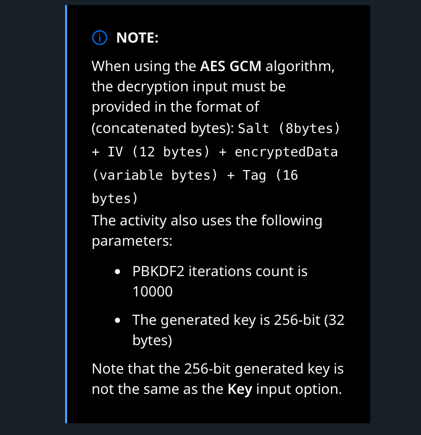

@marco.vanzanten2
Please check this …looks like this is the issue.Please follow below format
@Anil_G
I already saw this note, but that is related to the Windows Legacy compatibility mode.
The one i am using is in Windows compatibility mode.
So i am curious about what data i need to fill in into the variables of the activity.
The content from the JSON file is directly stored as a string into the strCipherText variable
And Base64 key it directly stored as a string into the strKey variable.
It might be that i need to convert the strKey, but i just don’t now which conversion type i need to use.

@marco.vanzanten2
Can you try to give all the values as mentioned in note itself…I beleive we need to pass all those values…and there is no other field…so trying it might bot be so bad
