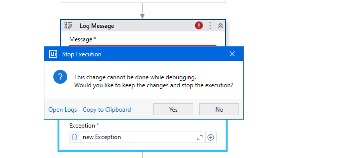

I just want to put 1 activity “log message” for dubug
Hi @Hieu_Nguyen1
You can click on Yes, the log message actiivty which you kept will be placed but you will have to start running your process from start.
Regards
@Hieu_Nguyen1,
This depends on the UiPath Studio you are using. If you are on Community edition 24.4.0 then you can edit the code while debugging but if you are on enterprise version, I guess, the feature is not yet available.
