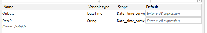

Hi @Robotics,
Actually, create a variable called var_Date and set the datatype as DateTime, and also create another variable var_Str and datatype would be string only.
Then,
Store the incoming datetime value in var_Date, and assign the value for var_Str as var_Str = var_Date.ToString(“dd/mm/yyyy”).
Print the var_Str value in the output panel, and you would achieve the output.
