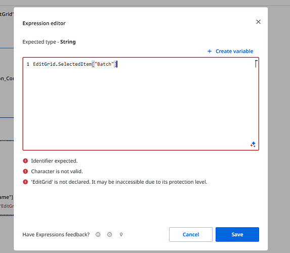

I am trying to bind it but encountered this issue,
You cannot directly pass that try this: go to variables then add variable of type Record (for entire row) and name →varSelectedRow then bind Selected Item Property for that select the Edit Grid control → In Properties → Selected Item → set it to varSelectedRow.
Access Column Value and for this go to expression editor, use varSelectedRow["Batch"]
