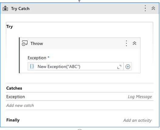

              Hi @Ashok98
Can you confirm if this how your try catch looks?
catch
IS the runtime error showing the same message you used in throw activity?

              @Rahul_Unnikrishnan
The above image which you shared that is correct, As You given the customized message it is populated
Let me know if you any query
