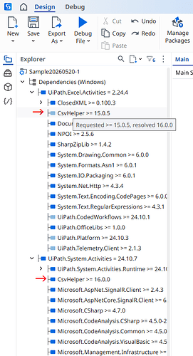

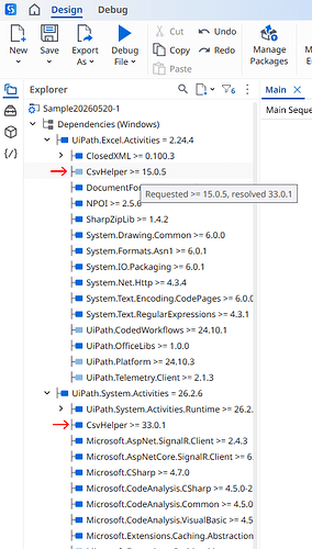

  • I have confirmed the following with the same CSV file and settings:
① Windows Project
UiPath.System.Activities = 26.2.4
→ Cannot execute due to the above error.
② Windows Project
UiPath.System.Activities = 24.10.7
→ Can read CSV normally.
③ Windows-Legacy Project

To be a bit more specific,
when the project.json is as follows, “reading the CSV activity results in an error.”
“dependencies”: {
“UiPath.Excel.Activities”: “[2.24.4]”,
“UiPath.FTP.Activities”: “3.0.0”,
“UiPath.Mail.Activities”: “[2.7.11]”,
“UiPath.System.Activities”: “[26.2.4]”,
“UiPath.Testing.Activities”: “[25.10.2]”,
“UiPath.UIAutomation.Activities”: “[25.10.28]”
However,
when the project.json is as follows, “the CSV reading activity can be executed.”
“dependencies”: {
“UiPath.Mail.Activities”: “[1.24.2]”,
“UiPath.System.Activities”: “[24.10.7]”,
“UiPath.Testing.Activities”: “[24.10.4]”,
“UiPath.UIAutomation.Activities”: “[24.10.11]”
Both processes have the same “UiPath.Excel.Activities”: “[2.24.4]”

In the case of Excel Pack 2.24.4 + System Pack 26.2.4, the dependency of the System Pack uses CSV Helper version 33.0.1, which is the reason it doesn’t work with Excel Pack 2.24.4.
In the case of Excel Pack 2.24.4 + System Pack 24.10.7, the dependency of the System Pack uses CSV Helper version 16.0.0, and this version works with Excel Pack 2.24.4.
