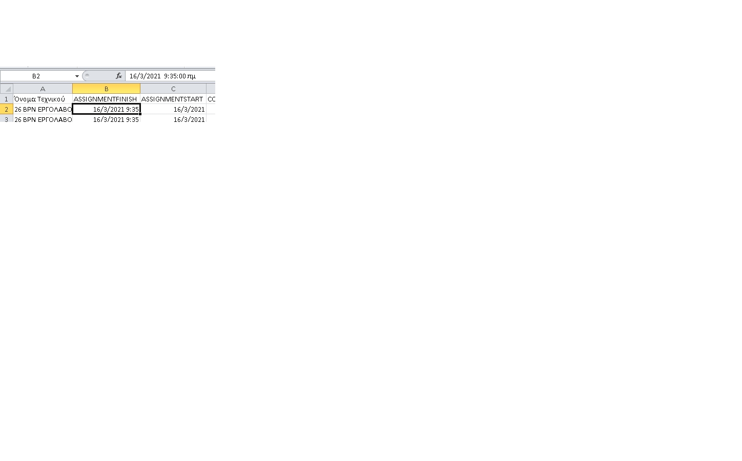

As you can see from the image, the data on row 40688 is correct (greek format) and the data on row 40689 don’t have the correct format.
For instance, the cell M 40689 need to change from “3/17/2021 8:51:00 PM” to “17/3/2021 8:51:00 μ.μ.”.

The information exists, but it doesn’t appear properly. There are no other date formats. I’ll try what you suggest. @NIVED_NAMBIAR I’ll check it and I’ll tell you.
@Hiba_B The format “dd/MM/yyyy hh:mm” is alright in the cell, but it doesn’t display the “ss tt” at the end, although it exists (above, in the function line of excel).
