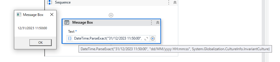

HI,
Can you try the following expression, because MM means 2 digit month, mm means 2 digits minute and HH means 24hour style hour.
DateTime.ParseExact(row("test_datetime").ToString, "dd/MM/yyyy HH:mm:ss", System.Globalization.CultureInfo.InvariantCulture)
