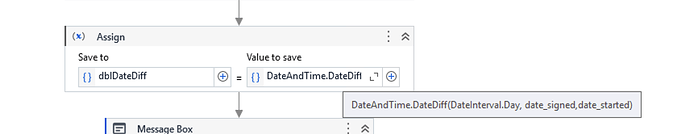

@dutta.marina
Can you tell where is it failing?ideally that should give you the difference properly…unless dateparsing gave different date items
@Anil_G
I was getting in negative result sometimes.
@dutta.marina
then you can use Math.abs(Expression)
it depends on start and end values
if signed date is after the other date or so
cheers
