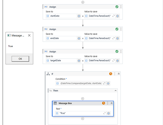

Hi @sruthesanju
Assign: startDate = DateTime.ParseExact("03/01/2022", "MM/dd/yyyy", System.Globalization.CultureInfo.InvariantCulture)
Assign: endDate = DateTime.ParseExact("03/31/2022", "MM/dd/yyyy", System.Globalization.CultureInfo.InvariantCulture)
Assign: targetDate = DateTime.ParseExact("03/28/2022", "MM/dd/yyyy", System.Globalization.CultureInfo.InvariantCulture)
If (DateTime.Compare(targetDate, startDate) >= 0 AndAlso DateTime.Compare(targetDate, endDate) <= 0)
  Message Box:True

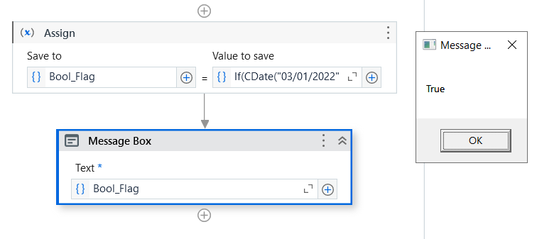

Hi @sruthesanju
Create a Variable with Boolean datatype called Bool_Flag.
- Assign -> Bool_Flag = If(CDate("03/01/2022") < CDate("03/28/2022") AndAlso CDate("03/31/2022") > CDate("03/28/2022"),True,false)
The Bool_Flag will give the Output as True if date is in between the two dates,
Output is False if date is not in between the tow dates.
Hope it helps!!
