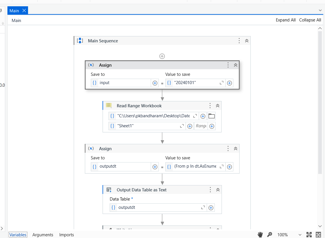

Hello All,
I am getting an input date in string format “20240101” and have adatatable which contains a column with date values .
I need to get the rows whose date value is greater than input date which is “20240101” in this example.
Can any one help how can we achieve this? I tried using filter datatable but its not giving appropriate results.
Any suggestion will be appreciated.

Hi @HappyCoding
Please use the attached XAML File
Happy Automation
FilterDate.xaml (8.8 KB)
