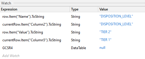

HI Ben,
After run the project in Debug mode below is the final status.
CurrentRow.Item(“Column5”).ToString should be TIER2 not TIER1
Hey @Asitabha_Deb_asitabhad,
I would have expected CurrentRow.Item(“Column5”).ToString to be TIER1 for one of the rows, if you are still using the data from your first post. That shows that, for this column, row 1 is TIER 1, row 2 is TIER 2, row 3 is TIER 3. If you are using different data, we might want to revisit the column.
I believe its possible this error is coming because GCSR4 is null right there. I know at one point you had changed the write activity to an append. It might be worth looking into that again, and using append in the loop, and a final write outside.

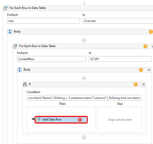

Lets start with a method of adding each row that matches your conditions to a datatable. We can then use that datatable to write all of the rows at once to Sheet3, after the loops have completed.
Currently, your filter is adding all rows in your Override DT that match that filter every time your conditions are met. To change this to only add the rows that meet the conditions, try removing the filter activity and adding an “Add Data Row” activity instead. You can use the same output DT that you were using in Filter. For input, simply have “row” (or “currentRow” if you want to add from the other DT).

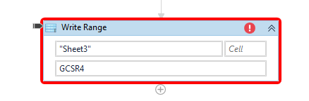

Finally, move the “Write range” outside of your loops and write the DT that you have been adding to to sheet3. That should get you what you are looking for.
One more thing to note. It looks like you could combine your “if” statements into one using “and”. This might make your workflow a little easier to follow. I’ve done that in the screenshot as well. Let me know how these steps work for you.
Why its giving me error.
I was added it under sequence but same error showing.
Might be that the DataTable you are trying to add rows to needs to be initialized.
This can be done in a few ways, but for this go to the variables panel, find the variable for your DataTable and add “new System.Data.DataTable” to the default field.
Still, no luck.
Row belongs to Override dt. I have added “New System.Data.DataTable” on it
Which DT is the one being added to in the Add Data Row activity? Is it GCSR5? Can you take a screen shot of the properties of that activity? If it is GCSR5, add “New System.Data.DataTable” to that one. Override doesn’t need it, you can remove from that.
Ok,
Now I have added GCSR5 in “Add Data Row”. Let me try with this one.
Same error with GCSR5
Okay, if it won’t accept like that, try to change it so that Add Data Row uses ArrayRow (not DataRow) and do row.ItemArray. Screenshot below.
Do I need to add “New System.Data.DataTable” in GCSR5?
Yes, exactly. Make sure GCSR5 has default of New System.Data.DataTable.
Now I am getting these.
Okay. Lets change default of GCSR5. Replace “New System.Data.DataTable” with “Override.Clone()”. .Clone should copy the Schema of the Override DT, giving you all of the same columns. Which should get rid of that error.
