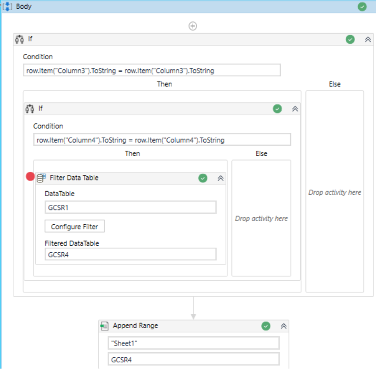

Hi @Asitabha_Deb_asitabhad ,
Based on the screenshot you have attached.
Can you please drop the write range outside the loop and try it?
Thanks,
Ashwin
Instead of using the write range activity in the for each row. Switch that to an Append Range. This will add the new values to the end of the 3rd sheet. The write range activity is rewriting over the previous data each time the loop is executed.
The issue is at Filter data table inside your 2nd for loop. The thing is you’re trying to filter the datatable each and every time when the if condition is getting satisfied. and Each time when the IF condition is getting satisfied you’re filtering the fresh GCR1 table and storing it from scratch into GCR4 because of of which are getting nothing.
Solution : instead of filtering the GCR1 you create a datatable on top of 1st for loop with the schema you want and then use ADD DATA ROW activity to the created datatable inside the IF block.
Refer the below picture for the error pointing.
let me know if you are still unable to resolve your issue.

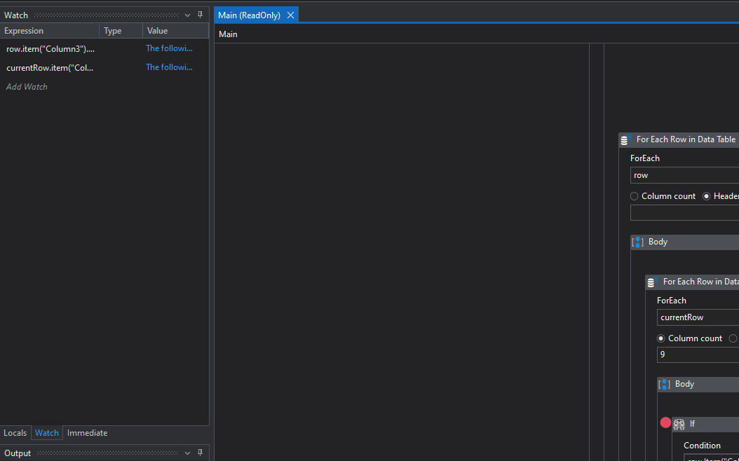

We can try to debug this and figure out what needs to be done, if you’d like. To start, I notice that you are using a nested for each loop. Both loops are using “row” as the variable to iterate through. Lets try renaming one of those to currentRow. That will allow us to more easily see what may be happening with each loop. I’ll attach a screenshot to illustrate. Also, if you can add a few breakpoints, as shown in screenshot, and debug. Once in debug, open “Watch” panel and add “row.item(“Column3”).ToString” and “currentRow.item(“Column3”).ToString”. Once you hit the breakpoint on the if, see what the values are for each of those in the watch panel. If those values never match, its likely not comparing what you intend.
HI,
its returning nothing I guess.

Now, I guess both the below expression are not giving me correct result.
row.Item(“Column3”).ToString = row.Item(“Column3”).ToString
row.Item(“Column4”).ToString = row.Item(“Column4”).ToString
Okay. So from what I can see, Column3 has no value in it. If you look at the output for the OverrideDT, you can see that Sales_Document has a value of “607975297”, Sales_Document_Item has a value of “110”, Name has a value of “Disposition Level”, and Value has a value of “Tier 2”. This all makes sense from your prior screenshot. However, if you notice, Column1, Column2, and Column3 are all empty values (that is what the “,” is showing, between each , is separating a value for a column). Which value are you attempting to reference? “Disposition Level”?
Remember that one of your iterators is likely now currentRow. So, to test if that is going to be true, it should be currentRow.Item(“Column3”).ToString = row.Item(“Column3”).ToString and currentRow.Item(“Column4”).ToString = row.Item(“Column4”).ToString.
