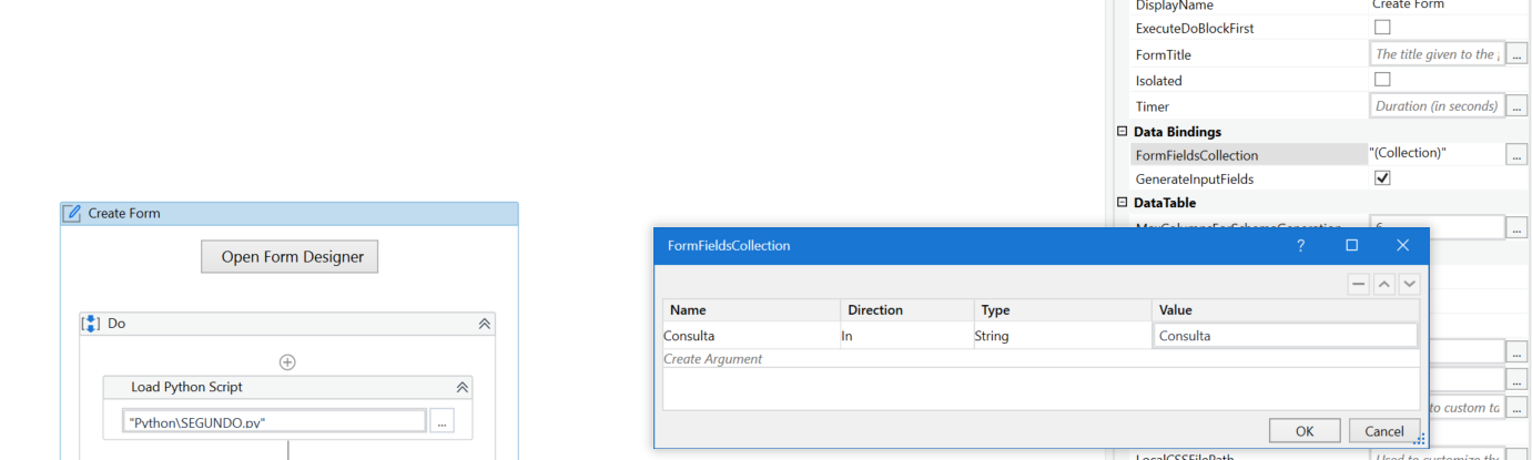

i have a form in uipath that makes a query (the user writes the query) and a phyton runs the process, but i can’t connect them.

I would like to send to call a uipath variable to Phython, since the string text that goes inside the Form will be called in a Phyton variable that will process said query for a database

We could pass the values to the Python Method using the InputParameters Property in Invoke Python Method Activity.
Let us know what you want to achieve in a bit more detail if the above doesn’t help.
Hello, I have not been able to find the solution since when invoking the method I have to do it after the script but the text string has to be called before the script
